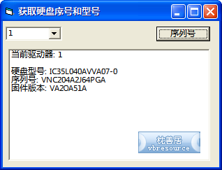

建窗体,窗体放置1个ComBox,命名为cbDrive,1个ListBox,命名为lstMain,一个CommandButton,命名为cmdGo,添加如下代码:
Dim h As clsMainInfo
Private Sub cmdGo_Click()
    Dim hT As Long
    Dim uW() As Byte
    Dim dW() As Byte
    Dim pW() As Byte
    Set h = New clsMainInfo
    With h
        .CurrentDrive = Val(cbDrive.Text)
         lstMain.Clear
         lstMain.AddItem "当前驱动器: " & .CurrentDrive
         lstMain.AddItem ""
         lstMain.AddItem "硬盘型号: " & .GetModelNumber
         lstMain.AddItem "序列号: " & .GetSerialNumber
         lstMain.AddItem "固件版本: " & .GetFirmwareRevision
    End With
    Set h = Nothing
End Sub
Private Sub Form_Load()
    cbDrive.AddItem 0
    cbDrive.AddItem 1
    cbDrive.AddItem 2
    cbDrive.AddItem 3
    cbDrive.ListIndex = 0
End Sub
