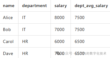

(1)聚合函数 + OVER()
计算每个部门的平均工资,同时保留每一行:
SELECT     name,    department,    salary,    AVG(salary) OVER (PARTITION BY department) AS dept_avg_salaryFROM employees;
结果:

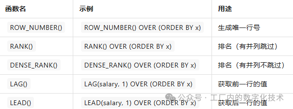

4. 常见窗口函数
