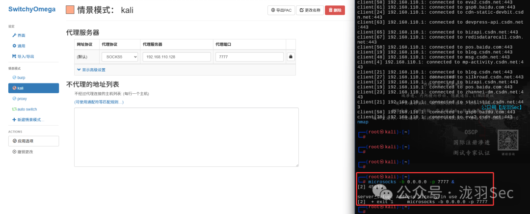

microsocks -b 0.0.0.0 -p 1080
调用参数简介
microsocks -1 -i listenip -p port -u user -P password -b bindaddr
# all arguments are optional. by default listenip is 0.0.0.0 and port 1080.
# option -1 activates auth_once mode: once a specific ip address authed successfully with user/pass, it is added to a whitelist and may use the proxy without auth. this is handy for programs like firefox that don't support user/pass auth. for it to work you'd basically make one connection with another program that supports it, and then you can use firefox too.
后台挂起运行,并将日志文件记录
nohup microsocks -p 8888 -u user -P pwd > microsocks.log &
