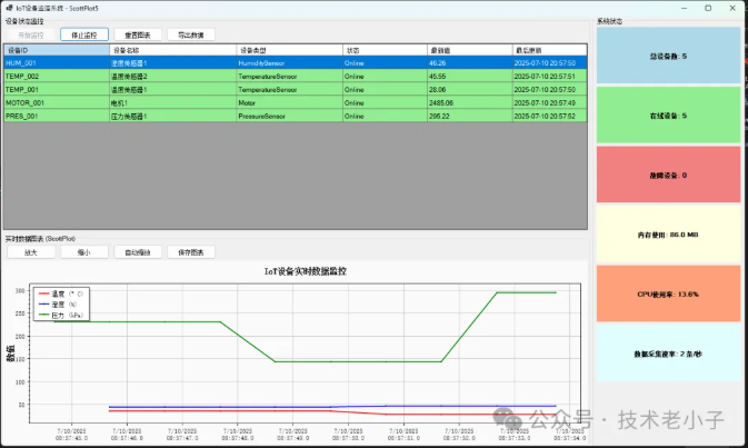

🎯 数据可视化实现
Nuget 安装ScottPlot.WinForms 5.0以上版本,这个版本变化较大。

    public partial class Form1 : Form
        private readonly IoTDeviceManager _deviceManager;
        private readonly DataCollectionMonitor _monitor;
        private readonly Timer _refreshTimer;
        private readonly Random _random = new Random();
        // ScottPlot 数据存储
        private readonly ConcurrentQueue<(DateTime time, double temp)> _tempData = new();
        private readonly ConcurrentQueue<(DateTime time, double humidity)> _humidityData = new();
        private readonly ConcurrentQueue<(DateTime time, double pressure)> _pressureData = new();
        // ScottPlot 绘图对象
        private ScottPlot.Plottables.Scatter _tempPlot;
        private ScottPlot.Plottables.Scatter _humidityPlot;
        private ScottPlot.Plottables.Scatter _pressurePlot;
        privateconstint MAX_DATA_POINTS = 100;
        public Form1()
            InitializeComponent();
            _deviceManager = new IoTDeviceManager();
            _monitor = new DataCollectionMonitor();
            // 设置刷新定时器
            _refreshTimer = new Timer();
            _refreshTimer.Interval = 1000// 1秒刷新一次
            _refreshTimer.Tick += RefreshTimer_Tick;
            InitializeDevices();
            InitializeScottPlot();
            InitializeDataGridView();
            _refreshTimer.Start();
        private void InitializeDevices()
            // 添加示例设备
            _deviceManager.AddDevice(new IoTDevice("TEMP_001""温度传感器1", DeviceType.TemperatureSensor));
            _deviceManager.AddDevice(new IoTDevice("TEMP_002""温度传感器2", DeviceType.TemperatureSensor));
            _deviceManager.AddDevice(new IoTDevice("HUM_001""湿度传感器1", DeviceType.HumiditySensor));
            _deviceManager.AddDevice(new IoTDevice("PRES_001""压力传感器1", DeviceType.PressureSensor));
            _deviceManager.AddDevice(new IoTDevice("MOTOR_001""电机1", DeviceType.Motor));
            // 启动所有设备
            _deviceManager.StartAllDevices();
        private void InitializeScottPlot()
            // 设置图表基本属性
            formsPlot.Plot.Title("IoT设备实时数据监控");
            formsPlot.Plot.XLabel("时间");
            formsPlot.Plot.YLabel("数值");
            formsPlot.Plot.Font.Set("SimSun");
            // 设置背景色
            formsPlot.Plot.FigureBackground.Color = ScottPlot.Color.FromHex("#FAFAFA");
            formsPlot.Plot.DataBackground.Color = ScottPlot.Color.FromHex("#FAFAFA");
            // 配置坐标轴
            formsPlot.Plot.Axes.DateTimeTicksBottom();
            formsPlot.Plot.Axes.AutoScale();
            // 创建数据系列
            _tempPlot = formsPlot.Plot.Add.Scatter(newdouble[0], newdouble[0]);
            _tempPlot.Color = ScottPlot.Color.FromHex("#FF0000");
            _tempPlot.LineWidth = 2;
            _tempPlot.MarkerSize = 3;
            _tempPlot.LegendText = "温度 (°C)";
            _humidityPlot = formsPlot.Plot.Add.Scatter(newdouble[0], newdouble[0]);
            _humidityPlot.Color = ScottPlot.Color.FromHex("#0000FF"); ;
            _humidityPlot.LineWidth = 2;
            _humidityPlot.MarkerSize = 3;
            _humidityPlot.LegendText = "湿度 (%)";
            _pressurePlot = formsPlot.Plot.Add.Scatter(newdouble[0], newdouble[0]);
            _pressurePlot.Color = ScottPlot.Color.FromHex("#008000"); ;
            _pressurePlot.LineWidth = 2;
            _pressurePlot.MarkerSize = 3;
            _pressurePlot.LegendText = "压力 (kPa)";
            // 显示图例
            formsPlot.Plot.ShowLegend(Alignment.UpperLeft);
            // 设置网格
            formsPlot.Plot.Grid.MajorLineColor = ScottPlot.Color.FromHex("#C8C8C8");
            formsPlot.Plot.Grid.MinorLineColor = ScottPlot.Color.FromHex("#E6E6E6");
            // 初始刷新
            formsPlot.Refresh();

                row.Cells[1].Value = device.DeviceName;
                row.Cells[2].Value = device.DeviceType.ToString();
                row.Cells[3].Value = device.Status.ToString();
                row.Cells[4].Value = device.LastValue?.ToString("F2") ?? "-";
                row.Cells[5].Value = device.LastUpdateTime.ToString("yyyy-MM-dd HH:mm:ss");
                // 根据状态设置行颜色
                if (device.Status == DeviceStatus.Online)
                    row.DefaultCellStyle.BackColor = System.Drawing.Color.LightGreen;
                elseif (device.Status == DeviceStatus.Error)
                    row.DefaultCellStyle.BackColor = System.Drawing.Color.LightPink;
                else
                    row.DefaultCellStyle.BackColor = System.Drawing.Color.LightGray;
                dgvDevices.Rows.Add(row);
        private void UpdateScottPlot()
            var now = DateTime.Now;
            // 获取并添加温度数据
            var tempDevice = _deviceManager.GetDevice("TEMP_001");
            if (tempDevice != null && tempDevice.LastValue.HasValue)
                _tempData.Enqueue((now, tempDevice.LastValue.Value));
                // 限制数据点数量
                while (_tempData.Count > MAX_DATA_POINTS)
                    _tempData.TryDequeue(out _);
            // 获取并添加湿度数据
            var humDevice = _deviceManager.GetDevice("HUM_001");
            if (humDevice != null && humDevice.LastValue.HasValue)
                _humidityData.Enqueue((now, humDevice.LastValue.Value));
                while (_humidityData.Count > MAX_DATA_POINTS)
                    _humidityData.TryDequeue(out _);
            // 获取并添加压力数据
            var presDevice = _deviceManager.GetDevice("PRES_001");
            if (presDevice != null && presDevice.LastValue.HasValue)
                _pressureData.Enqueue((now, presDevice.LastValue.Value));
                while (_pressureData.Count > MAX_DATA_POINTS)
                    _pressureData.TryDequeue(out _);
            // 更新图表数据
            UpdatePlotData();
        private void UpdatePlotData()
            // 更新温度数据
            if (_tempData.Count > 0)
                var tempArray = _tempData.ToArray();
                var tempX = tempArray.Select(d => d.time.ToOADate()).ToArray();
                var tempY = tempArray.Select(d => d.temp).ToArray();
                // 移除旧的图表并添加新的
                formsPlot.Plot.Remove(_tempPlot);
                _tempPlot = formsPlot.Plot.Add.Scatter(tempX, tempY);
            // 更新湿度数据
            if (_humidityData.Count > 0)
                var humArray = _humidityData.ToArray();
                var humX = humArray.Select(d => d.time.ToOADate()).ToArray();
                var humY = humArray.Select(d => d.humidity).ToArray();
                formsPlot.Plot.Remove(_humidityPlot);
                _humidityPlot = formsPlot.Plot.Add.Scatter(humX, humY);
            // 更新压力数据
            if (_pressureData.Count > 0)
                var presArray = _pressureData.ToArray();
                var presX = presArray.Select(d => d.time.ToOADate()).ToArray();
                var presY = presArray.Select(d => d.pressure).ToArray();
                formsPlot.Plot.Remove(_pressurePlot);
                _pressurePlot = formsPlot.Plot.Add.Scatter(presX, presY);
            // 重新显示图例
            // 自动缩放并刷新
        private void UpdatePerformanceMetrics()
            // 更新性能指标显示
            var totalDevices = _deviceManager.GetAllDevices().Count();
            var onlineDevices = _deviceManager.GetAllDevices().Count(d => d.Status == DeviceStatus.Online);
            var errorDevices = _deviceManager.GetAllDevices().Count(d => d.Status == DeviceStatus.Error);
            lblTotalDevices.Text = $"总设备数: {totalDevices}";
            lblOnlineDevices.Text = $"在线设备: {onlineDevices}";
            lblErrorDevices.Text = $"故障设备: {errorDevices}";
            // 更新系统性能
            var process = Process.GetCurrentProcess();
            lblMemoryUsage.Text = $"内存使用: {process.WorkingSet64 / 1024 / 1024:F1} MB";
            lblCpuUsage.Text = $"CPU使用率: {GetCpuUsage():F1}%";
            // 更新数据采集速率
            lblDataRate.Text = $"数据采集速率: {_deviceManager.GetDataRate():F0} 条/秒";
        private double GetCpuUsage()
            // 简单的CPU使用率计算
            return _random.NextDouble() * 20 + 10// 模拟10-30%的CPU使用率
        private void btnStartMonitoring_Click(object sender, EventArgs e)
            btnStartMonitoring.Enabled = false;
            btnStopMonitoring.Enabled = true;
            MessageBox.Show("监控已启动""信息", MessageBoxButtons.OK, MessageBoxIcon.Information);
        private void btnStopMonitoring_Click(object sender, EventArgs e)
            _deviceManager.StopAllDevices();
            _refreshTimer.Stop();
            btnStartMonitoring.Enabled = true;
            btnStopMonitoring.Enabled = false;
            MessageBox.Show("监控已停止""信息", MessageBoxButtons.OK, MessageBoxIcon.Information);
        private void btnResetChart_Click(object sender, EventArgs e)
            // 清空所有数据
            while (_tempData.TryDequeue(out _)) { }
            while (_humidityData.TryDequeue(out _)) { }
            while (_pressureData.TryDequeue(out _)) { }
            // 完全清空图表并重新初始化
            formsPlot.Plot.Clear();
            MessageBox.Show("图表已重置""信息", MessageBoxButtons.OK, MessageBoxIcon.Information);
        private void btnExportData_Click(object sender, EventArgs e)
            var saveDialog = new SaveFileDialog
                Filter = "CSV files (*.csv)|*.csv",
                Title = "导出设备数据"
            if (saveDialog.ShowDialog() == DialogResult.OK)
                ExportDeviceData(saveDialog.FileName);
                MessageBox.Show("数据导出成功""信息", MessageBoxButtons.OK, MessageBoxIcon.Information);
        private void ExportDeviceData(string fileName)
            var csv = new StringBuilder();
            csv.AppendLine("设备ID,设备名称,设备类型,状态,最新值,最后更新时间");
            foreach (var device in _deviceManager.GetAllDevices())
                csv.AppendLine($"{device.DeviceId},{device.DeviceName},{device.DeviceType}," +
                             $"{device.Status},{device.LastValue},{device.LastUpdateTime}");
            System.IO.File.WriteAllText(fileName, csv.ToString(), Encoding.UTF8);
        private void btnZoomIn_Click(object sender, EventArgs e)
            formsPlot.Plot.Axes.Zoom(0.80.8);
        private void btnZoomOut_Click(object sender, EventArgs e)
            formsPlot.Plot.Axes.Zoom(1.21.2);
        private void btnAutoScale_Click(object sender, EventArgs e)
        private void btnSaveChart_Click(object sender, EventArgs e)
                Filter = "PNG files (*.png)|*.png|JPEG files (*.jpg)|*.jpg",
                Title = "保存图表"
                formsPlot.Plot.Save(saveDialog.FileName, formsPlot.Width, formsPlot.Height);
                MessageBox.Show("图表已保存""信息", MessageBoxButtons.OK, MessageBoxIcon.Information);
        protected override void OnFormClosing(FormClosingEventArgs e)
            _refreshTimer?.Stop();
            _deviceManager?.Dispose();
            _monitor?.Dispose();
            base.OnFormClosing(e);
