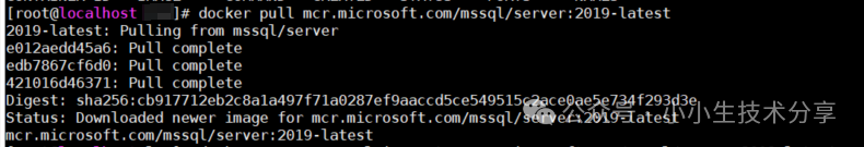

1. 获取官方镜像
Microsoft提供官方SQL Server 2019 Linux容器镜像:
docker pull mcr.microsoft.com/mssql/server:2019-latest

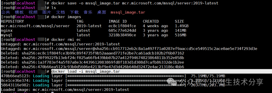

导出命令
docker save -o mssql_image.tar mcr.microsoft.com/mssql/server:2019-latest
在目标机器执行命令:
docker load -i mssql_image.tar
 即可载入 image

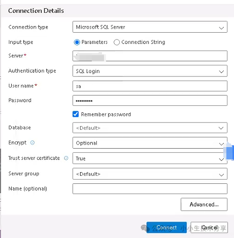

1.使用Azure Data Studio连接SQL Server 2019
下载地址
https://learn.microsoft.com/zh-cn/azure-data-studio/download-azure-data-studio?tabs=win-install%2Cwin-user-install%2Credhat-install%2Cwindows-uninstall%2Credhat-uninstall#download-azure-data-studio

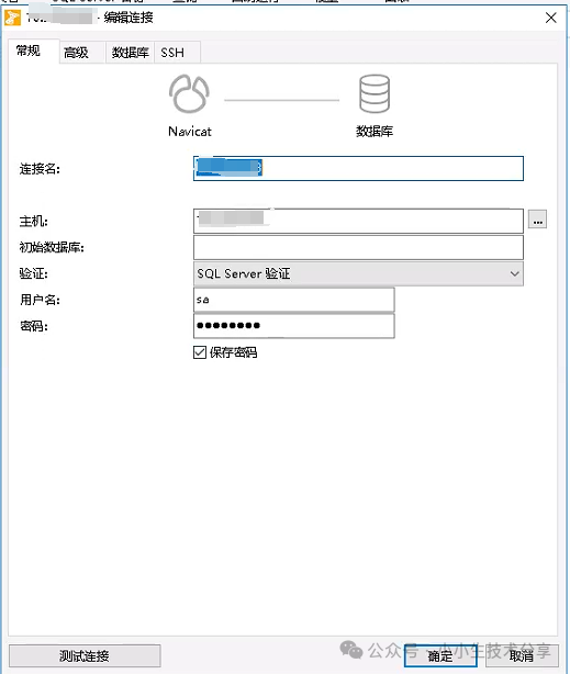

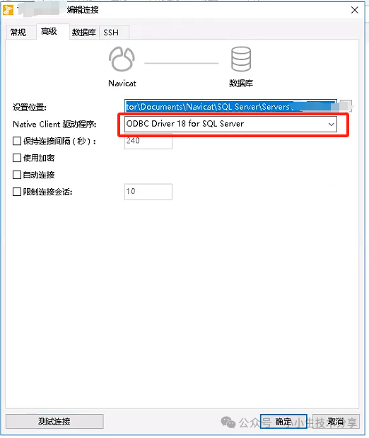

2.使用navicat连接SQL Server 2019
驱动程序要选择ODBC Driver 18 for SQL Server
下载地址:
https://learn.microsoft.com/en-us/sql/connect/odbc/download-odbc-driver-for-sql-server?view=sql-server-ver17
