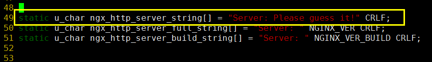

(1)vim src/http/ngx_http_header_filter_module.c               #修改49行
static u_char ngx_http_server_string[] = "Server: Please guess it!" CRLF;    #Server后写上你自定义的服务器信息

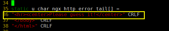

(2)vim src/http/ngx_http_special_response.c      #修改36行
"<hr><center>Please guess it!</center>" CRLF    #再写一遍刚才的字符串
