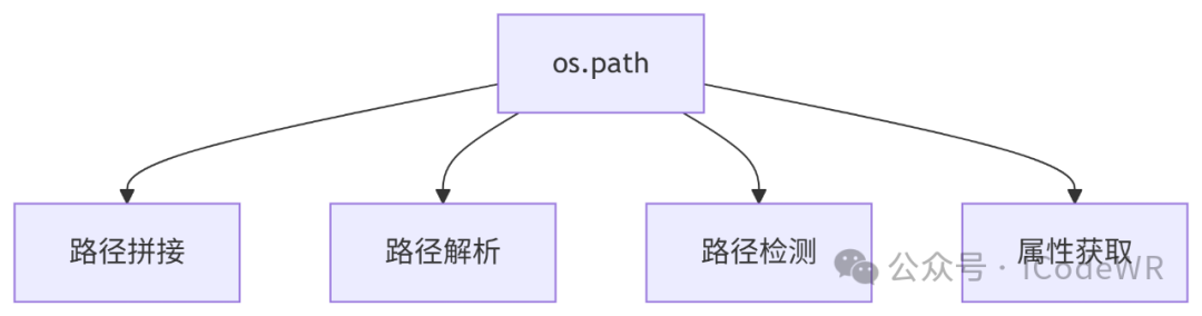

三、路径操作(os.path子模块)
1. 核心功能
2. 详细用法
# 路径拼接
full_path = os.path.join("dir""subdir""file.txt")
# 路径解析
print(os.path.basename(full_path))  # file.txt
print(os.path.dirname(full_path))   # dir/subdir
# 路径分割
dir_part, file_part = os.path.split(full_path)
name, ext = os.path.splitext(file_part)
# 路径检测
print(os.path.exists(full_path))
print(os.path.isfile(full_path))
print(os.path.isdir(full_path))
3. 注意事项
  • 使用os.path.join()代替字符串拼接
    ,确保跨平台兼容性
  • 检查路径是否存在再进行操作
  • 注意路径大小写敏感问题(Linux vs Windows)

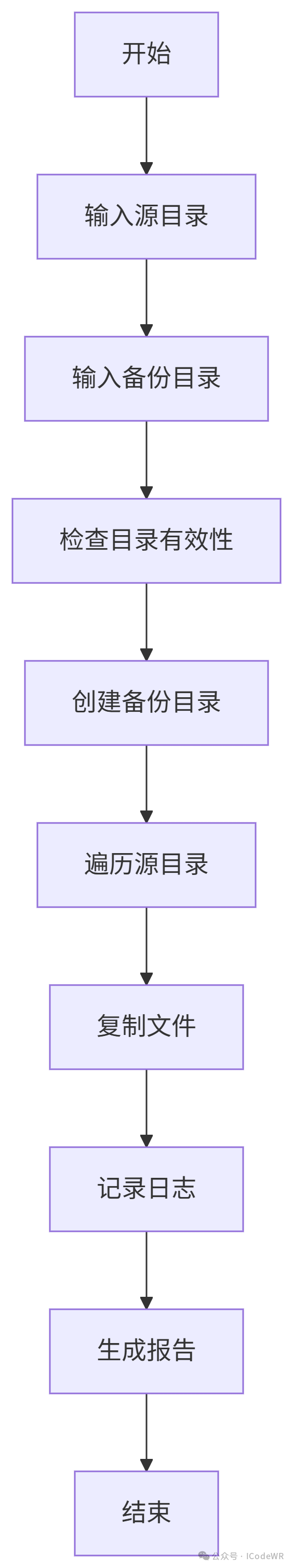

八、综合应用举例:文件备份工具
1. 需求分析
2. 代码实现
import os
import shutil
import datetime
import hashlib
defbackup_directory(source, destination):
    """备份目录并生成校验报告"""
    # 创建备份目录
    timestamp = datetime.datetime.now().strftime("%Y%m%d_%H%M%S")
    backup_path = os.path.join(destination, f"backup_{timestamp}")
    os.makedirs(backup_path, exist_ok=True)
    # 初始化日志
    log_path = os.path.join(backup_path, "backup_log.txt")
    report = []
    # 遍历源目录
    file_count = 0
    total_size = 0
    for root, dirs, files in os.walk(source):
        # 在备份中创建对应目录
        rel_path = os.path.relpath(root, source)
        dest_dir = os.path.join(backup_path, rel_path)
        os.makedirs(dest_dir, exist_ok=True)
        for file in files:
            src_file = os.path.join(root, file)
            dest_file = os.path.join(dest_dir, file)
            # 复制文件
            shutil.copy2(src_file, dest_file)
            # 计算文件哈希
            withopen(src_file, "rb"as f:
                file_hash = hashlib.md5(f.read()).hexdigest()
            # 记录信息
            file_stat = os.stat(src_file)
            report.append({
                "source": src_file,
                "destination": dest_file,
                "size": file_stat.st_size,
                "modified": file_stat.st_mtime,
                "hash": file_hash
            file_count += 1
            total_size += file_stat.st_size
    # 写入日志
    withopen(log_path, "w"as log:
        log.write(f"Backup Report - {timestamp}\n")
        log.write(f"Source: {source}\n")
        log.write(f"Destination: {backup_path}\n")
        log.write(f"Files: {file_count}\n")
        log.write(f"Total Size: {total_size / (1024*1024):.2f} MB\n\n")
        for entry in report:
            log.write(f"{entry['source']} -> {entry['destination']}\n")
            log.write(f"  Size: {entry['size']} bytes\n")
            log.write(f"  Modified: {datetime.datetime.fromtimestamp(entry['modified'])}\n")
            log.write(f"  MD5: {entry['hash']}\n\n")
    print(f"备份完成! 文件数: {file_count}, 总大小: {total_size / (1024*1024):.2f} MB")
    print(f"日志文件: {log_path}")
if __name__ == "__main__":
    source_dir = input("请输入源目录: ").strip()
    backup_dir = input("请输入备份目录: ").strip()
    ifnot os.path.isdir(source_dir):
        print("错误: 源目录不存在")
    elifnot os.path.isdir(backup_dir):
        print("错误: 备份目录不存在")
    else:
        backup_directory(source_dir, backup_dir)
3. 功能简介
  1. 自动创建带时间戳的备份目录
  2. 保留文件元数据(修改时间等)
  3. 计算文件哈希值确保完整性
  4. 生成详细备份报告
  5. 支持大文件处理

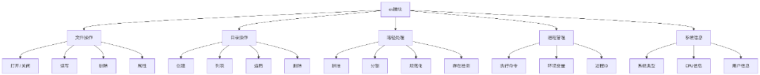

知识图谱
总结
os模块提供了与操作系统交互的丰富接口。通过本教程,我们可以学到:
  1. 文件与目录操作的核心方法
  2. 路径处理的跨平台技巧
  3. 进程管理和系统信息获取
  4. 文件描述符等高级功能
  5. 安全实践和性能优化
  6. 完整实用的综合案例
掌握os模块可以大幅提升Python在系统管理、文件操作和自动化任务方面的能力。建议结合shutilpathlib等模块使用,构建更健壮的应用程序。
