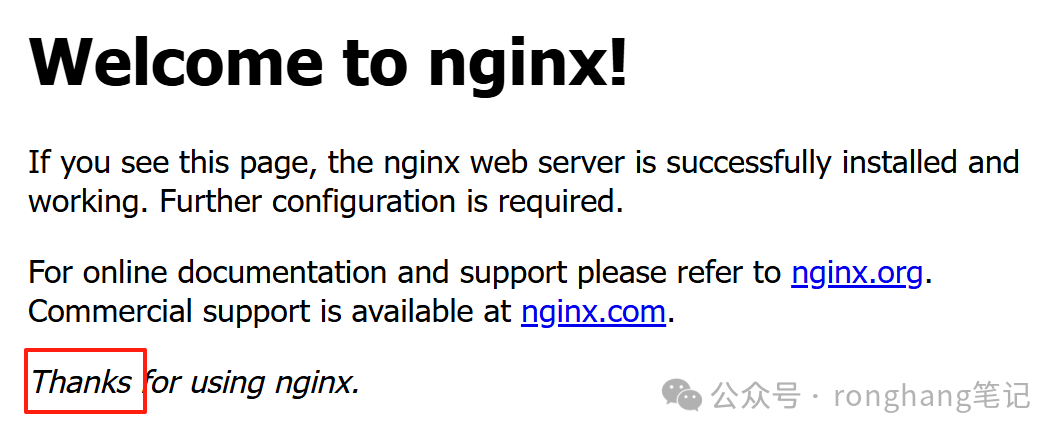

  5. 测试
    • Thank you改为Thanks
      server {
       listen 80;
       server_name localhost;
       location / {
        root html;
        sub_filter 'Thank you' 'Thanks';

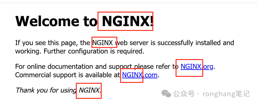

    • 将nginx全部替换为NGINX
      server {
       listen 80;
       location / {
        root html;
        sub_filter 'nginx' 'NGINX';
        sub_filter_once off;

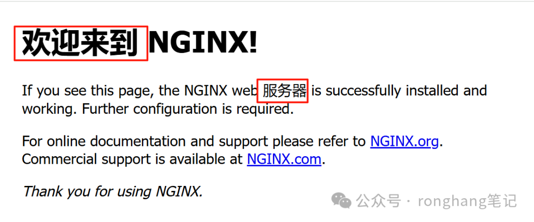

    • 同时修改多项内容
      server {
       listen 80;
       location / {
        root html;
        sub_filter 'nginx''NGINX';
        sub_filter '<head>''<head><meta charset="UTF-8">'
        sub_filter 'server''服务器';
        sub_filter 'Welcome to''欢迎来到';

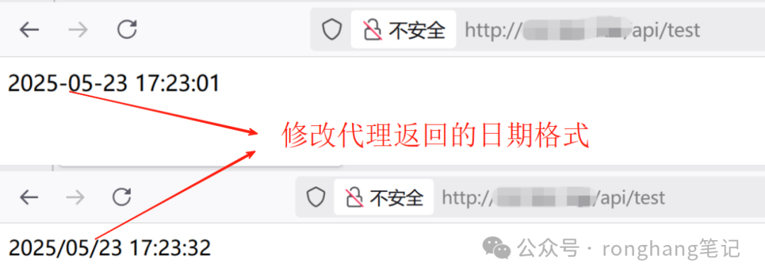

    • 修改代理返回的内容
      server {
       listen 80;
       location / {
        root html;
       location /api/ {
        proxy_pass http://192.168.1.16:8086/;
        sub_filter '-''/';
