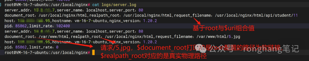

变量用途举例,记录日志:
http {
 log_format about_server_log 'server_addr:$server_addr,server_name:$server_name,server_port:$server_port\n'
        'document_root:$document_root,realpath_root:$realpath_root,request_filename:$request_filename\n'
        'host:$host,hostname:$hostname,nginx_version:$nginx_version\n'
        'pid:$pid,limit_rate:$limit_rate';
 server {
  listen 80;
  server_name localhost;
  access_log logs/server.log about_server_log;
        location / {
            root   /var/www/html;
            index  index.html index.htm;
  location /api/ {
   proxy_pass http://localhost:8009/api/;
   limit_rate 100k;
请求http://xxx.xxx.xxx.xxx/5.jpg时,$document_root值为root指令配置的路径,为软链接,$realpath_root的值为真实物理路径。请求http://xxx.xxx.xxx.xxx/api/student/11时由代理服务响应,$request_filename值是基于root的配置与$uri组合得出的:
