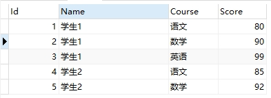

表结构如下
脚本如下
CREATE TABLE `t_student`  (  `Id` int NOT NULL AUTO_INCREMENT,  `Name` varchar(50CHARACTER SET utf8mb4 COLLATE utf8mb4_0900_ai_ci NOT NULL,  `Course` varchar(255CHARACTER SET utf8mb4 COLLATE utf8mb4_0900_ai_ci NULL DEFAULT NULL,  `Score` int NOT NULL DEFAULT 0,  PRIMARY KEY (`Id`) USING BTREE) ENGINE = InnoDB AUTO_INCREMENT = 3 CHARACTER SET = utf8mb4 COLLATE = utf8mb4_0900_ai_ci ROW_FORMAT = Dynamic;
-- ------------------------------ Records of t_student-- ----------------------------INSERT INTO `t_student` VALUES (1'学生1''语文'80);INSERT INTO `t_student` VALUES (2'学生1''数学'90);INSERT INTO `t_student` VALUES (3'学生1''英语'99);INSERT INTO `t_student` VALUES (4'学生2''语文'85);INSERT INTO `t_student` VALUES (5'学生2''数学'92);
