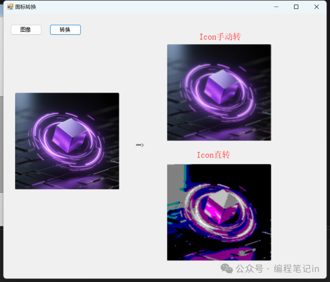

两种转换方式效果比较:
    如下图,左图为自定义实现转换,右图为直接使用Icon转换。
运行效果

public partial class MainForm : Form
   private string sourcePath = null;
   private Image sourceImage;
   private Image targetImage;
   public MainForm()
       InitializeComponent();
   private void btn_SelectedImage_Click(object sender, EventArgs e)
       OpenFileDialog openFile = new OpenFileDialog();
       openFile.InitialDirectory = Application.StartupPath;
       openFile.Filter = "(图像文件)|*.png;*.jpg;*.jpeg;*.bmp";
       if (openFile.ShowDialog() == DialogResult.OK)
           sourcePath = openFile.FileName;
           sourceImage = Image.FromFile(sourcePath);
           picx_SourceImage.Image = sourceImage;
   private void btn_ConvertImage_Click(object sender, EventArgs e)
       ConvertToIcon(sourcePath, "output1.ico", (byte)128);
       picx_TargetImage.Image = Image.FromFile("output1.ico");
       ConvertToIcon(sourcePath, "output2.ico", 128);
       picx_TargetImage2.Image = Image.FromFile("output2.ico");
