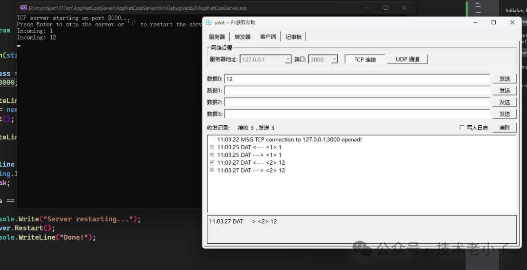

创建TCP服务器
让我们从一个简单的TCP服务器示例开始:
using NetCoreServer;
using System.Net.Sockets;
namespace AppNetCoreServer
    class EchoServer : TcpServer
        public EchoServer(string address, int port) : base(address, port) { }
        protected override TcpSession CreateSession() returnnew EchoSession(this); }
        protected override void OnError(SocketError error)
            Console.WriteLine($"Echo server caught an error with code {error}");
    class EchoSession : TcpSession
        public EchoSession(TcpServer server) : base(server) { }
        protected override void OnReceived(byte[] buffer, long offset, long size)
            string message = System.Text.Encoding.UTF8.GetString(buffer, (int)offset, (int)size);
            Console.WriteLine("Incoming: " + message);
            SendAsync(message);
            Console.WriteLine($"Echo session caught an error with code {error}");
    internal class Program
        static void Main(string[] args)
            string address = "127.0.0.1";
            int port = 3000;
            Console.WriteLine($"TCP server starting on port {port}...");
            var server = new EchoServer(address, port);
            server.Start();
            Console.WriteLine("Press Enter to stop the server or '!' to restart the server...");
            for (; ; )
                string line = Console.ReadLine();
                if (string.IsNullOrEmpty(line))
                    break;
                if (line == "!")
                    Console.Write("Server restarting...");
                    server.Restart();
                    Console.WriteLine("Done!");
            Console.Write("Server stopping...");
            server.Stop();
这个例子创建了一个简单的回显服务器,它会将接收到的任何消息发送回客户端。

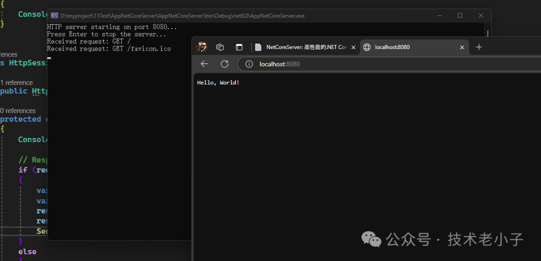

HTTP服务器
NetCoreServer也支持创建HTTP服务器。以下是一个简单的HTTP服务器示例:
    class HttpServer : NetCoreServer.HttpServer
        public HttpServer(string address, int port) : base(address, port) { }
        protected override TcpSession CreateSession() returnnew HttpSession(this); }
            Console.WriteLine($"HTTP server caught an error with code {error}");
    class HttpSession : NetCoreServer.HttpSession
        public HttpSession(NetCoreServer.HttpServer server) : base(server) { }
        protected override void OnReceivedRequest(HttpRequest request)
            Console.WriteLine($"Received request: {request.Method} {request.Url}");
            // Respond with "Hello, World!"
            if (request.Method == "GET" && request.Url == "/")
                var content = "Hello, World!";
                var response = new HttpResponse();
                response.SetBegin(200);
                response.SetBody(content);
                SendResponseAsync(response);
            else
                SendResponseAsync(Response.MakeErrorResponse());
        protected override void OnReceivedRequestError(HttpRequest request, string error)
            Console.WriteLine($"Request error: {error}");
            Console.WriteLine($"HTTP session caught an error with code {error}");
            int port = 8080;
            Console.WriteLine($"HTTP server starting on port {port}...");
            var server = new HttpServer(address, port);
            server.Start();
            Console.WriteLine("Press Enter to stop the server...");
            Console.ReadLine();
            server.Stop();
这个HTTP服务器会对根路径 ("/") 的GET请求响应 "Hello, World!"。

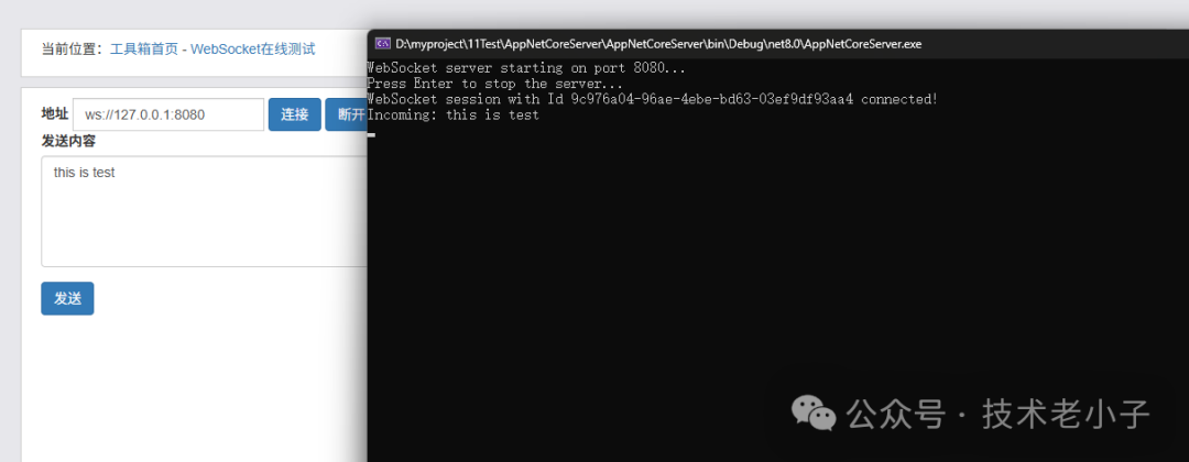

WebSocket服务器
NetCoreServer还支持WebSocket协议。以下是一个WebSocket服务器的示例:
using System;
using System.Text;
class WebSocketServer : WsServer
    public WebSocketServer(string address, int port) : base(address, port) { }
    protected override TcpSession CreateSession() returnnew WebSocketSession(this); }
        Console.WriteLine($"WebSocket server caught an error with code {error}");
class WebSocketSession : WsSession
    public WebSocketSession(WsServer server) : base(server) { }
    public override void OnWsConnected(HttpRequest request)
        Console.WriteLine($"WebSocket session with Id {Id} connected!");
    public override void OnWsDisconnected()
        Console.WriteLine($"WebSocket session with Id {Id} disconnected!");
    public override void OnWsReceived(byte[] buffer, long offset, long size)
        string message = Encoding.UTF8.GetString(buffer, (int)offset, (int)size);
        Console.WriteLine($"Incoming: {message}");
        SendTextAsync(message);
        Console.WriteLine($"WebSocket session caught an error with code {error}");
class Program
        int port = 8080;
        Console.WriteLine($"WebSocket server starting on port {port}...");
        var server = new WebSocketServer(address, port);
        server.Start();
        Console.ReadLine();
        server.Stop();
这个WebSocket服务器会将接收到的任何消息回显给客户端。

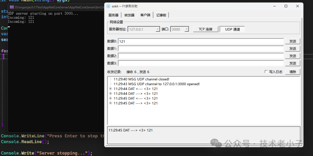

UDP服务器
NetCoreServer也支持UDP协议。以下是一个简单的UDP服务器示例:
using System.Net;
using System.Text;
    class EchoServer : UdpServer
        public EchoServer(IPAddress address, int port) : base(address, port) { }
        protected override void OnStarted()
            // Start receive datagrams
            ReceiveAsync();
        protected override void OnReceived(EndPoint endpoint, byte[] buffer, long offset, long size)
            Console.WriteLine("Incoming: " + Encoding.UTF8.GetString(buffer, (int)offset, (int)size));
            // Echo the message back to the sender
            SendAsync(endpoint, buffer, 0, size);
        protected override void OnSent(EndPoint endpoint, long sent)
            // Continue receive datagrams
            ReceiveAsync();
            Console.WriteLine($"Echo UDP server caught an error with code {error}");
    class Program
            int port = 3000;
            Console.WriteLine($"UDP server starting on port {port}...");
            var server = new EchoServer(IPAddress.Parse(address), port);
            server.Start();
            for (; ; )
                    break;
                // Restart the server
                if (line == "!")
                    server.Restart();
            Console.ReadLine();
            server.Stop();
这个UDP服务器会将接收到的任何消息回显给发送者。
