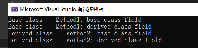

    internal class Program
           OtherClass oc = new OtherClass();
            oc.Method1(oc.field1);
            oc.Method1(oc.field2);
            oc.Method2(oc.field1);
            oc.Method2(oc.field2);
运行结果如下所示:

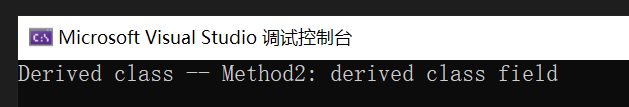

运行结果如下所示:

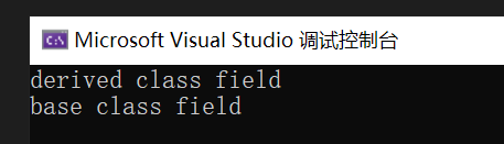

oc.PrintField1();
​运行结果如下所示:
