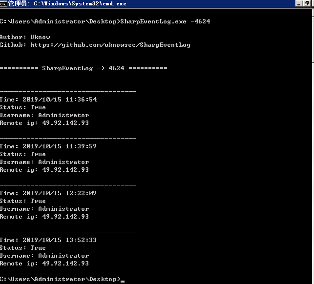

使用说明
打开cmd.exe
> SharpEventLog.exe
Author: Uknow
Github: https://github.com/uknowsec/SharpEventLog
Usage: SharpEventLog.exe -4624
       SharpEventLog.exe -4625
该文章在 2025/2/14 15:36:03 编辑过
