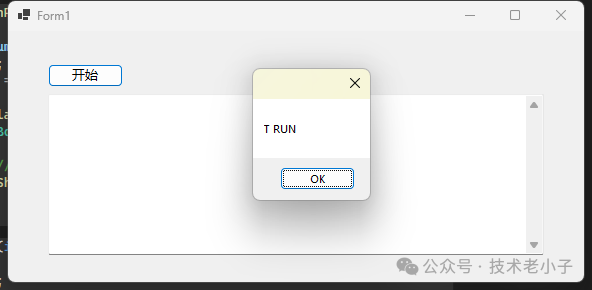

再来一个例子
private void btnRun_Click(object sender, EventArgs e)
    Task<int> sum = new Task<int>(() => Sum(1000000));
    sum.Start();
    Task.Run(() =>
        Task.Delay(5000).Wait();
        MessageBox.Show("T RUN");
    sum.Wait();//等待任务的完成执行过程
    MessageBox.Show(sum.Result.ToString());
private int Sum(int len)
    int sum = 0;
    for (int i = 0; i < len; i++)
        sum += i;
    return sum;
