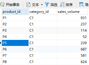

data_learning.product_order(商品销量表):

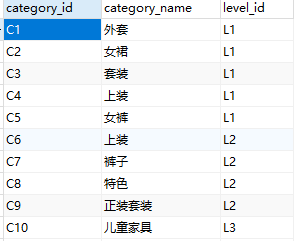

data_learning.product_category(商品二级分类信息表):
