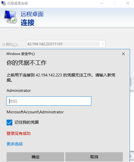

[mstsc]
type = tcp
1oca1_ip = 192.168.0.109
local_port = 3389
remote_port = 11101

测试
ssh,远程连接,http访问,tcp连接
