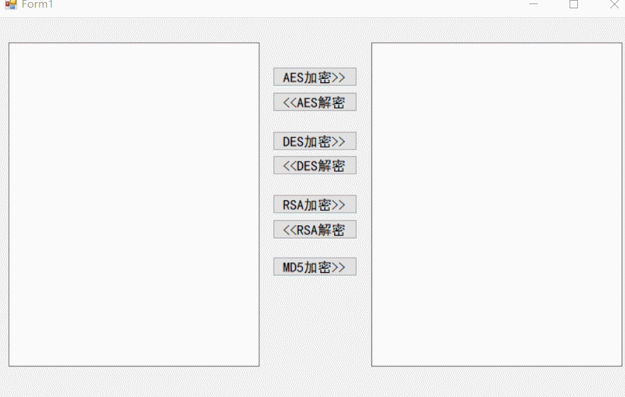

  RsaUtil.RsaKey rsaKey = new RsaUtil.RsaKey();        private void btn_Rsa_Encrypt_Click(object sender, EventArgs e)        {            rsaKey = RsaUtil.createKey();            string result = RsaUtil.Encrypt(textBox1.Text, rsaKey.PublicKey);            textBox2.Text = result;        }
private void btn_Rsa_Decrypt_Click(object sender, EventArgs e) { string result = RsaUtil.Decrypt(textBox2.Text, rsaKey.PrivateKey); textBox1.Text = result; }
实现效果:
