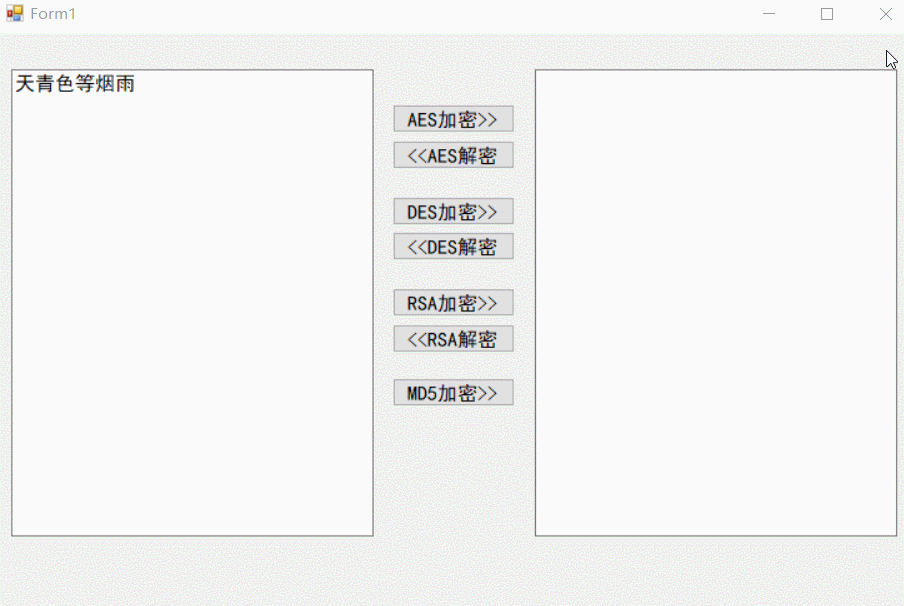

  private void btn_Des_Encrypt_Click(object sender, EventArgs e)        {            string result = DesUtil.Encrypt(textBox1.Text, "12345678900987654321");            textBox2.Text = result;        }
private void btn_Des_Decrypt_Click(object sender, EventArgs e) { string result = DesUtil.Decrypt(textBox2.Text, "12345678900987654321"); textBox1.Text = result;
实现效果:
