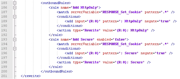

通过配置出站规则getcookie添加HttpOnly
在网站根目录下找到文件“Web.config”,在其中添加如下出站规则:
  1. <rewrite>
  2. <outboundRules>
  3. <rule name="Add HttpOnly">
  4. <match serverVariable="RESPONSE_Set_Cookie" pattern=".*" />
  5. <conditions>
  6. <add input="{R:0}" pattern="; HttpOnly" negate="true" />
  7. </conditions>
  8. <action type="Rewrite" value="{R:0}; HttpOnly" />
  9. </rule>
  10. <rule name="Add Secure">
  11. <match serverVariable="RESPONSE_Set_Cookie" pattern=".*" />
  12. <conditions>
  13. <add input="{R:0}" pattern="; Secure" negate="true" />
  14. </conditions>
  15. <action type="Rewrite" value="{R:0}; Secure" />
  16. </rule>
  17. </outboundRules>
  18. </rewrite>
添加完成后图示

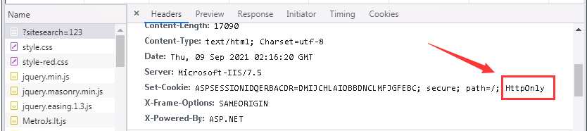

测试结果
搞定!

2022年9月26日 10:28
rewrite放置位置参考(代码不是上面的,不要照抄!):
<?xml version="1.0" encoding="UTF-8"?>
<configuration>
    <system.webServer>
        <rewrite>
            <rules>
                <rule name="root_location_rewrite" stopProcessing="true">
  		<match ignoreCase="false" url="."/>
  		<conditions logicalGrouping="MatchAll">
    		<add ignoreCase="false" input="{REQUEST_FILENAME}" matchType="IsFile" negate="true"/>
    		<add ignoreCase="false" input="{REQUEST_FILENAME}" matchType="IsDirectory" negate="true"/>
   </conditions>    <action appendQueryString="true" type="Rewrite" url="index.php?{QUERY_STRING}"/>                 </rule>                 <rule name="default_file_rewrite" stopProcessing="true">    <match ignoreCase="false" url="^$"/>    <action appendQueryString="true" type="Rewrite" url="index.php?{QUERY_STRING}"/>    </rule>             </rules>
</rewrite>     </system.webServer> </configuration>
